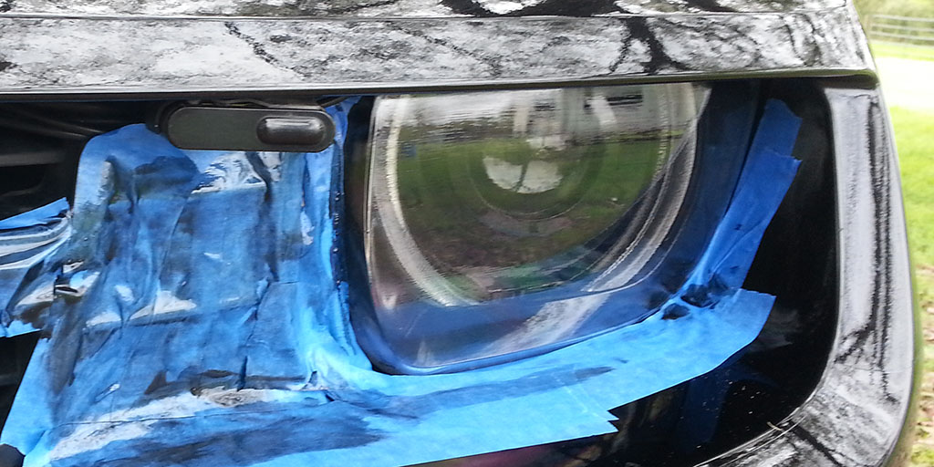

It has been said that only a small amount of Veil was required to get good performance so we set out to first apply a single coat of G5 to the head lights and fog lights of the ZL1. This is case 1 and is demonstrated in runs 1 and 2. In this case, we masked off the turn signal indicators, the chrome outlined Chevrolet logo, and the ZL1 badge and then applied G5 over the top of the painters tape to ensure we reduced as much of the reflections from these parts as we possibly could. The application of G5 to the head light was very smooth and looked really nice on the vehicle. After running this for a day it doesn't appear to have reduced the intensity of the head lights at all.
Attachment 3733

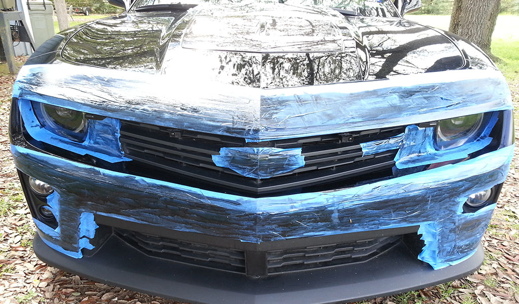

In runs 3 and 4 we went back and applied painters tape to ALL flat portions of the front of the vehicle and then coated the tape with Veil G5. The vehicle looked like one of those prototype testing vehicles you see the spy shots of from Car and Driver. The purpose was to reduce as much of the reflections from these parts as possible to ensure at distance we were not getting reflections from other parts of the vehicle. We also encountered some odd results in runs 1 & 2 and wanted to see if the problem persisted in the fully veiled vehicle.
Attachment 3734
