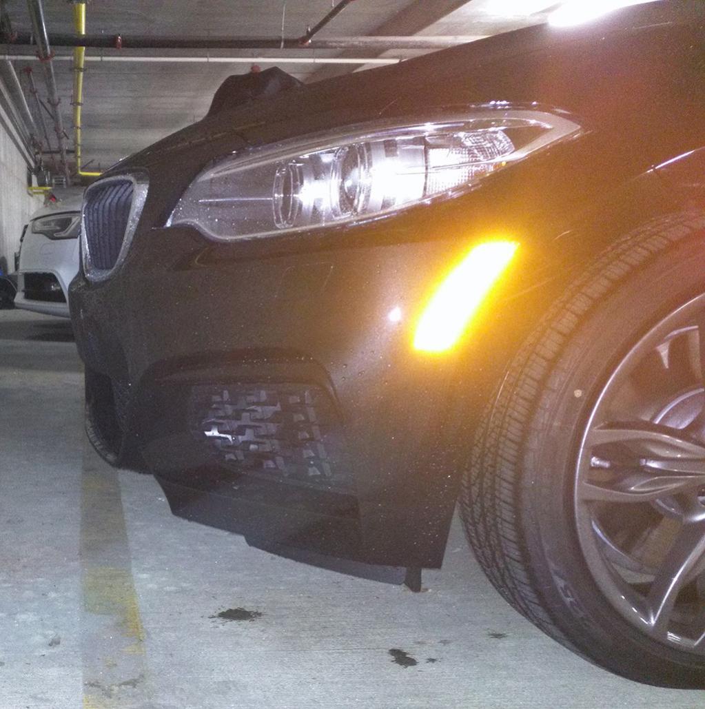

    I ran into a lot off issues getting access to those lower outside mesh grilles so ended up settling for a two sensor install for now. When I find the time to take the bumper off I'll go for the 3 sensor install based roughly on the green positions. But for now here's what it looks like...
Size:  293.3 KBName:  IMG_20151231_152750.jpg
Size:  291.0 KBName:  IMG_20151231_152801.jpg
    It's hard to tell from the pictures but I've got them pointing straight ahead (maybe off by a few degrees) and level parallel to the ground.
