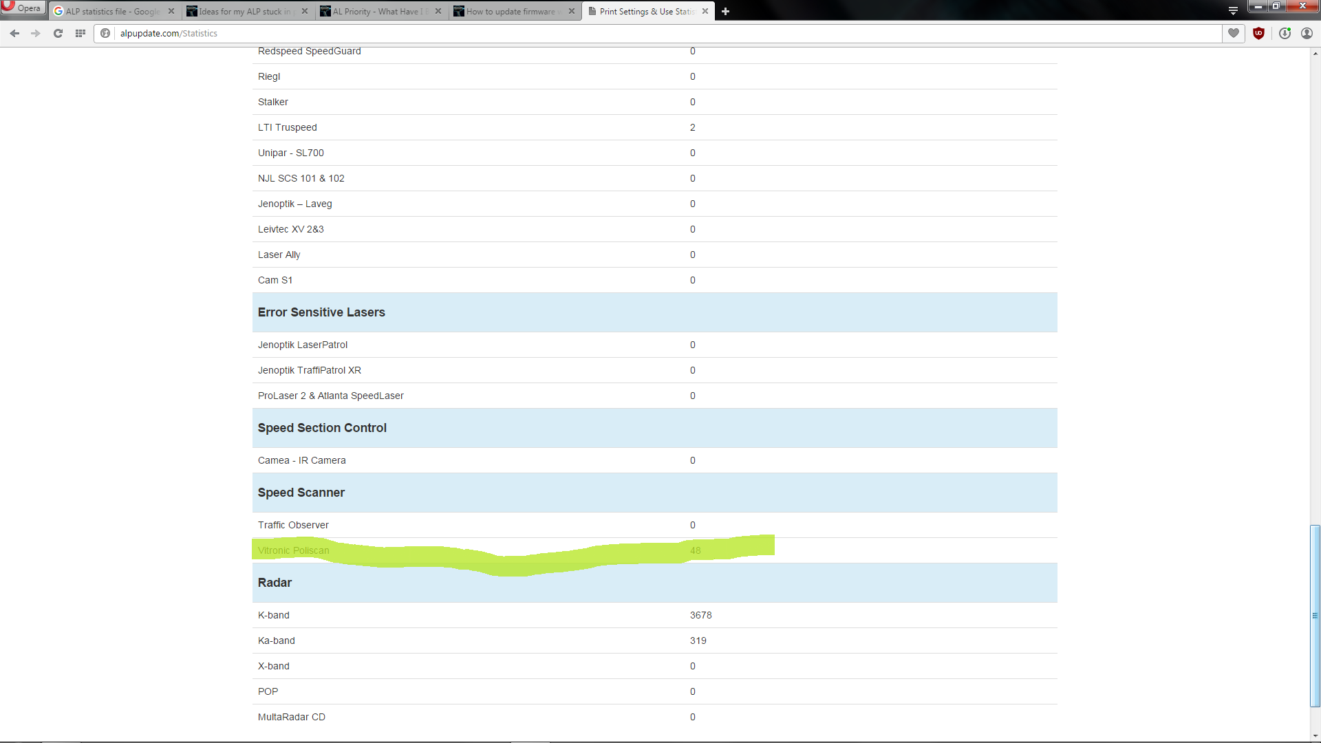

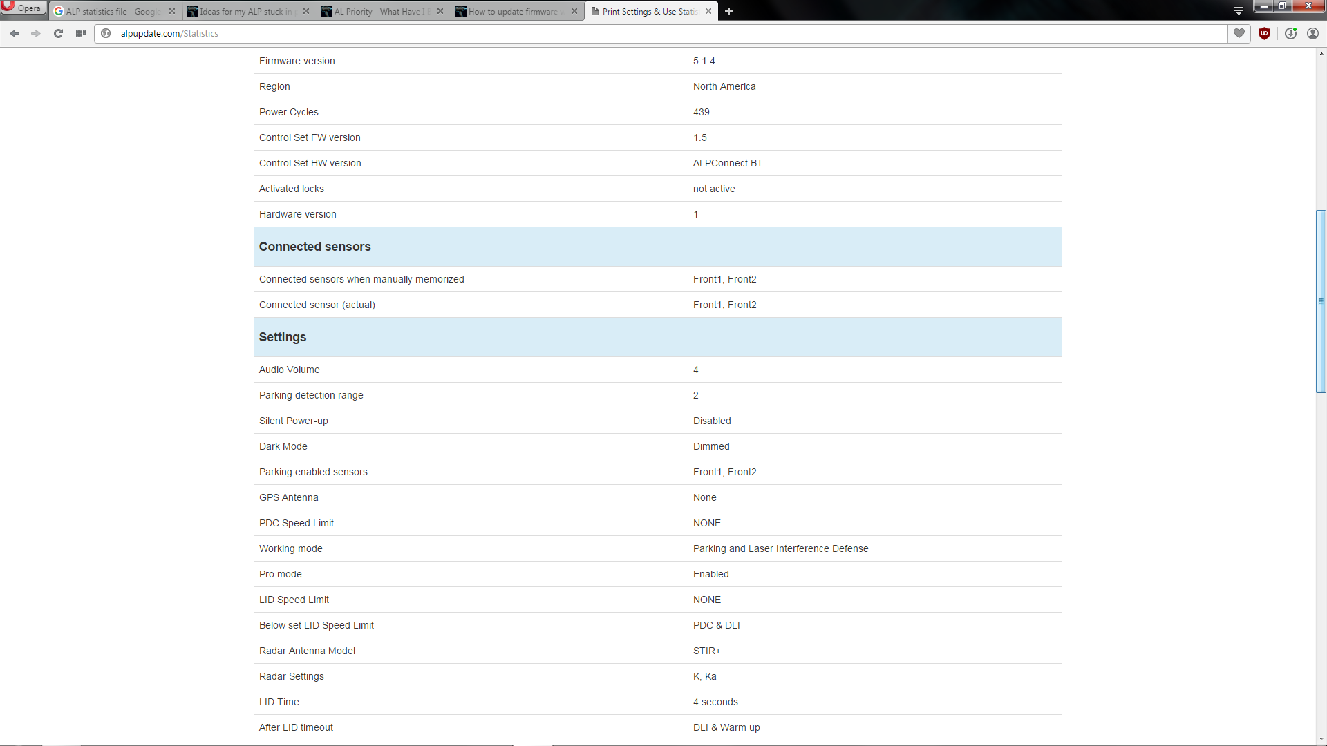

    Here is my stats file:
    Name:  ALP-1 11-06-15.png
Size:  91.2 KBName:  ALP-2 11-06-15.png
Size:  90.9 KBName:  ALP-3 11-06-15.png

    That is odd that it's staying in park mode until a radar alert. Maybe some odd bug that crops up due to your faulty head? Try disconnecting one head at a time and see if the problem goes away. If it does when you unplug one head, the problem is probably that head.
    Something else odd I noticed: in your statistics, your unit shows some of the overseas guns like Reigl, Laveg etc. as enabled. I don't see those when I go into ALP setup (North America), and my statistics show those as disabled.
    Maybe you're running with an old setup file from a prior firmware version? Try generating a new one at http://www.alpriorityupdate.com/Setup and loading it.

    I thought that was odd too... as I don't remember anything besides stalker/poliscan being set for options.
    As you can see in the first screenshot from my computer (top 2 lines):
    The firmware is updated to 5.1.4 (my understanding is this is the newest)
    And it is the "North American" database for region
    I have completely reset the unit, updated it the latest and greatest firmware, uninstalled the old app, and reinstalled the newest app.
