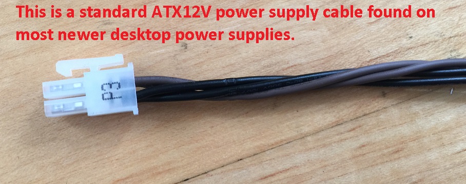

    1. Obtain a newer desktop power supply unit from a computer being tossed into the garbage, or one just lying around. Cut off the 4-pin ATX 12V cable and connector coming out of the power supply unit. The color of the wires will be different from the original ALP cable, but that doesn't matter.

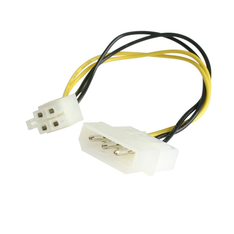

    2. Go to eBay or Amazon, and search for a "4-Pin ATX12V to 4-Pin Molex Adapter". See picture below, then cut off the Molex connector. I've seen these go for as cheap as $2.65.

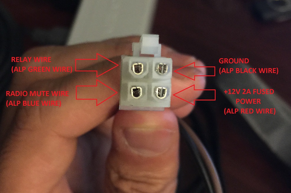

    I have the pinout/wiremapping provided in a picture diagram below. Be absolutely certain to connector the 12V Power to ONLY the cable that is in the position provided. If you provide 12V Power to the wrong wire, you could risk damage. Be very careful!

    ALP Power Cable Pinout

    My discarded/used 4-Pin ATX 12V Cable

    A picture of a 4-Pin ATX 12V to Molex Adapter

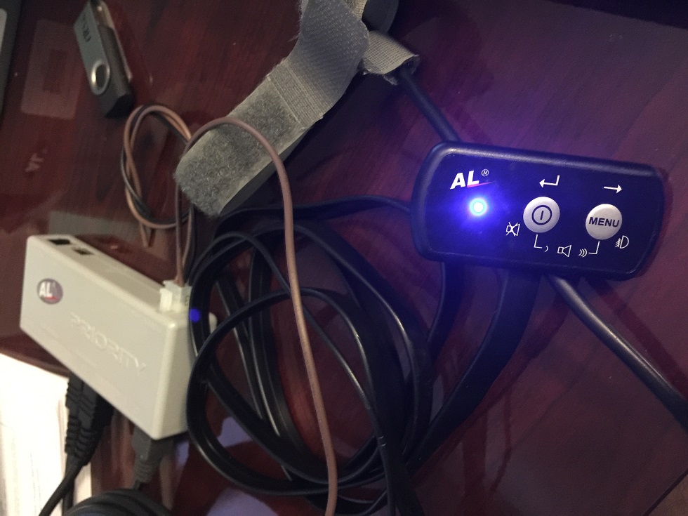

    Tested my 4-Pin ATX 12V Cable on my ALP. Everything works!
