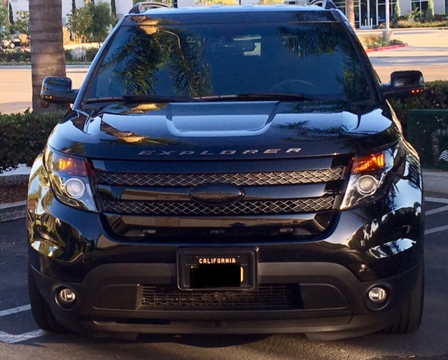

    Lost my recent small car to the floods in Houston. Looking at replacing it with a 2018 Ford Explorer. I had a triple head ALP set up on the old car that worked flawlessly. Based on the research I've done so far, it seems 3 heads should be sufficient to cover the front of the explorer as well. My question is around placement. I know the ideal thing would be to go with 2 outer ALP sensors and one of the new TX sensors in the middle, but I may hold off for a bit if I can on the tx sensor to save up some cash (the floods made a nice dent in my pocket with the car and also home damage). I can't seem to find too many installs on explorers but I did come across one where he placed his three ALP heads as shown below in the picture. The grill is open here and makes install super easy with no cutting into the grill above. Thoughts on this set up? THANKS FOR YOUR INPUT!!

    Sorry about your other car due to the hurricane. Nice replacement if you purchase this SUV. The placement for the sensors and to have the TX in the middle for full coverage.
  3. #3
    If you can only get 2 Transponders at this time (but a TX later on) you need to plan now for the final complete Front install in the future.
    With that in mind, your current 3 locations are good w/ an exception. The "outer" 2 Transponders will be greater than 24" apart & will not give sufficient protection against even Legacy Lidar guns as is. However, if you stay in the same current grill openings marked BUT move them "inward" each to the vertical plastic piece, I'm guessing the center-to-center spacing to each Transponder will be ~24".
    In the future all you would have to do is add the TX in the middle [& it would also be the perfect spacing (~12") ] required for a proper Triple install.

    Thank you red rocket for your reply! I actually do have three transponders now as I had a triple set up on my old car. So the install for this explorer would be 3 regular transponders installed in the locations shown in the picture. And then in the future. Change out the center transponder for a new tx sensor for added protection against new guns.

    Well now, that's a whole 'nuther issue & you should have said so from the start !
    In that case, I would stick w/ your original layout as you posted !!

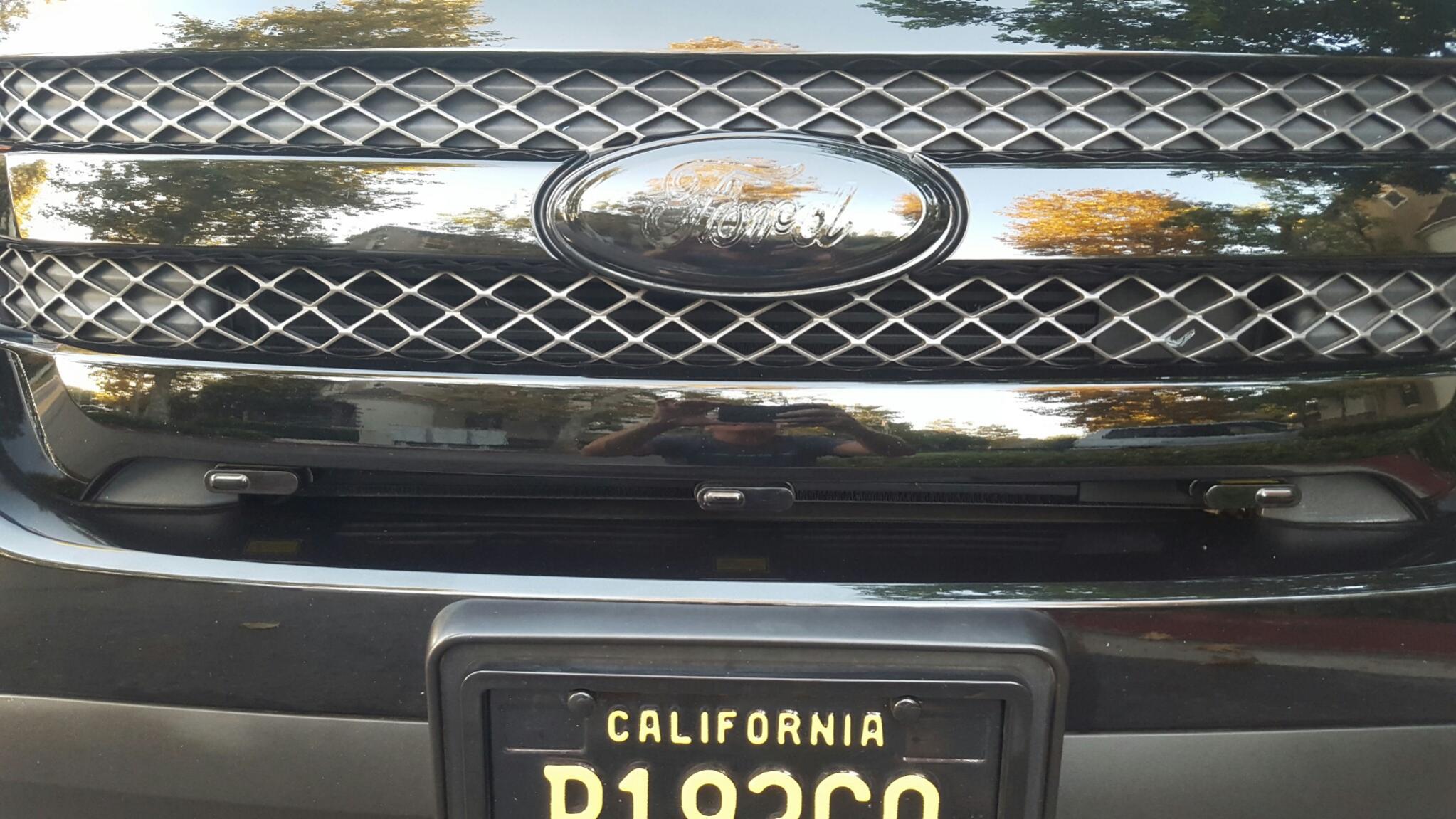

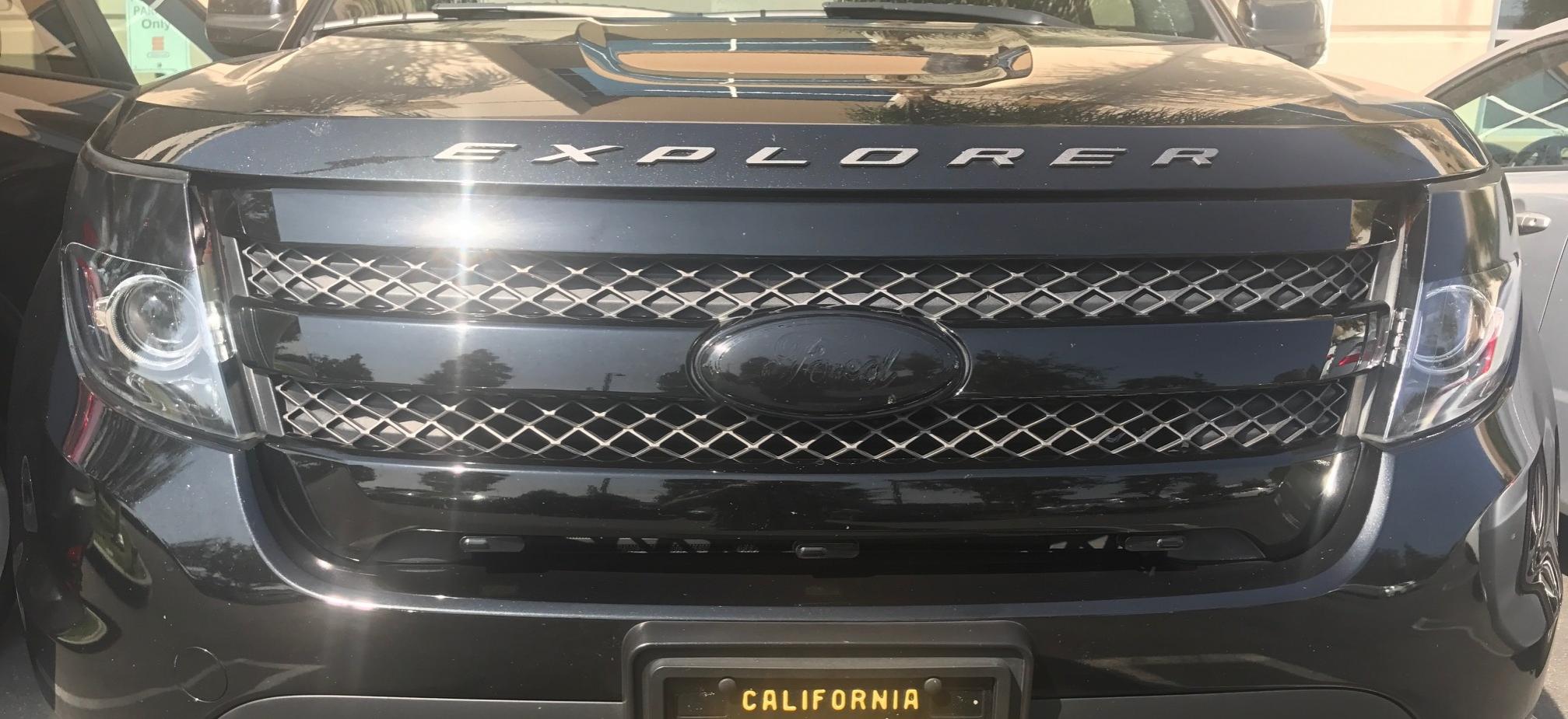

    Pretty much the same setup. New ride looks nice. And this tested very well with just about every gun we had at the testing site.
    http://radarandlaserforum.com/showth...-Plus-and-AL-PName:  IMG_1816.jpg

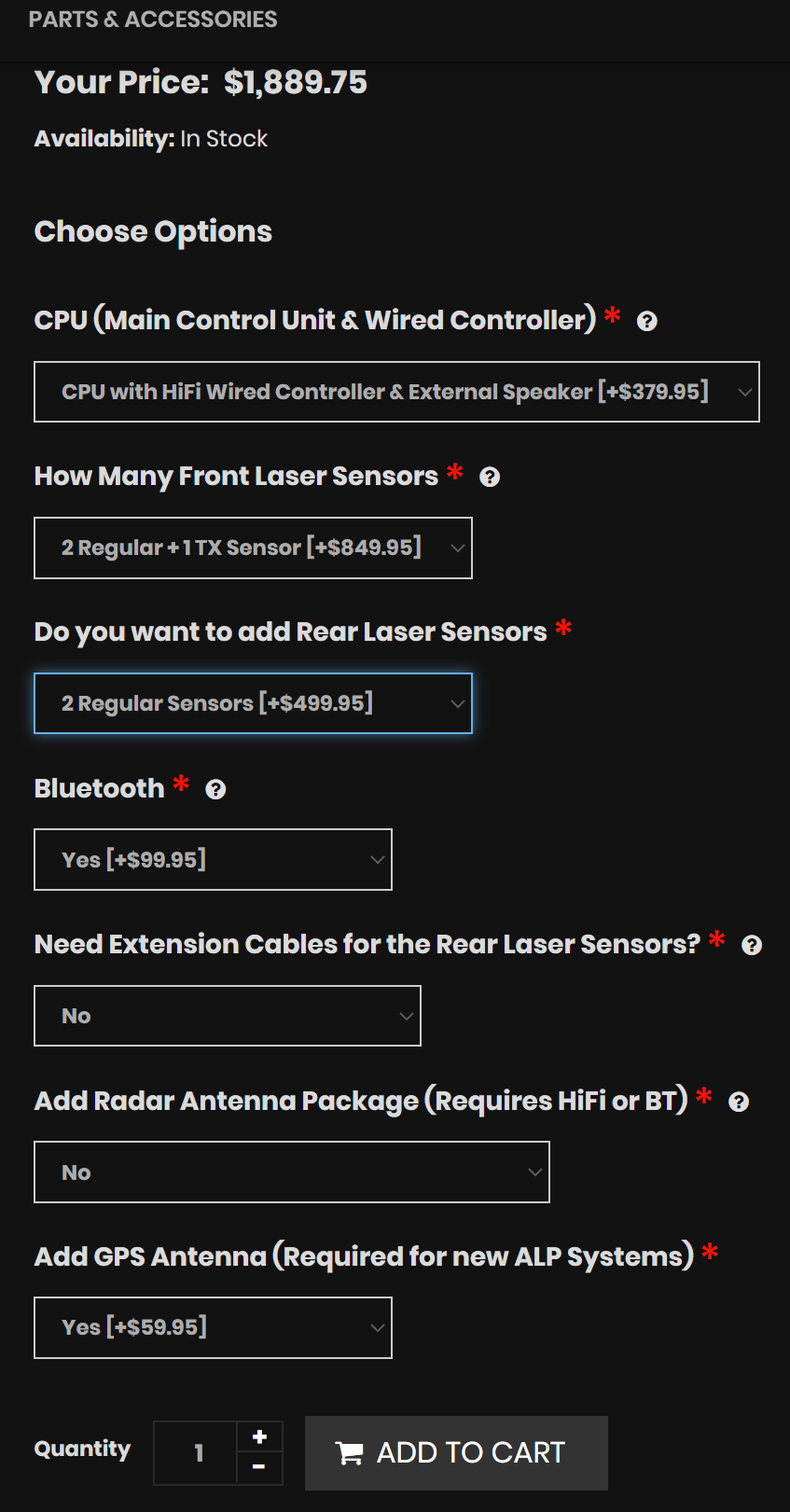

    Good day everyone. I'm hoping I don't need to start a new thread.
    I have a '19 Explorer Sport & I'm getting ready to add Laser protection.
    I'm not sure if I need to worry about rear protection, in Tennessee, but I do travel to Kentucky & might drive through Indiana to Illinois.
    This is what I'm thinking that I'll need to buy.
    My question(s) is/are:
    1) Does anyone know if I'm wasting money on the rear transponders for my area?
    If I'm needed them, would the far sides of the plate indented area be where to mount them?
    If I add the rear transponders, do I need extension cable(s)?
    2) Is the mounting location, in the post above, still considered the best placement?
    I'm opting for professional installation, from a shop that installs audio/alarms/remote-starters

    I'm not familiar w/ your States enforcement tactics so for now you can take a pass on Rear protection until you determine if they are needed in the future. (on a large vehicle like your's, you probably would need extension cables)
