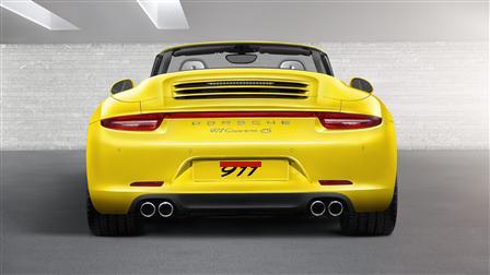

You have limited mounting options on the rear, basically the only place is above the rear license plate.

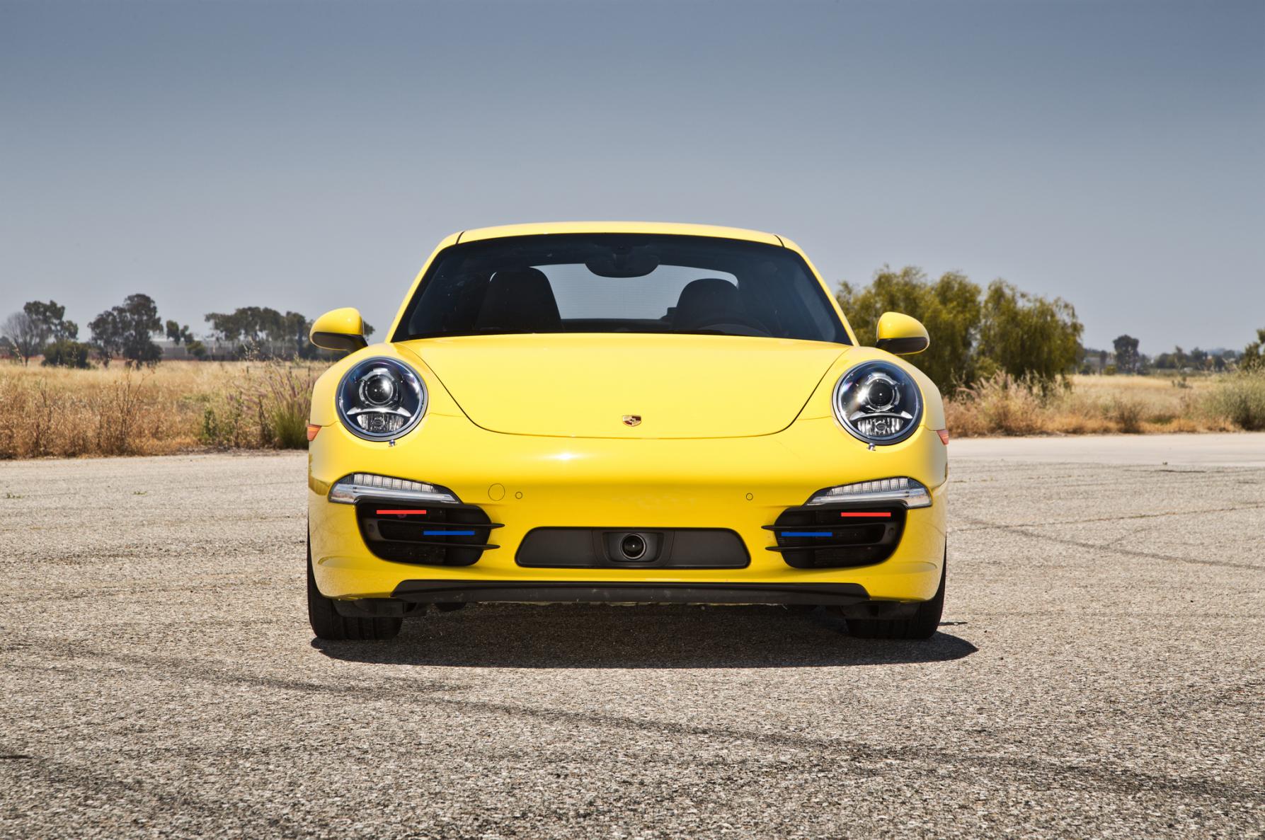

On the front I recommend mounting on the grill of the two side radiators and one head on the top center of the central radiatior.

For the front of the car, I'm thinking about mounting it in the areas marked red in the attached image. For the back of the car, I'm planning on just mounting it on the rear license plate.
2 heads for the front, 1 head in the back

You need 2 heads on each end of the car you want to protect. Red is the right height but the heads are too far apart. Bring both heads closer as far to the center as you can get in the same slot.
For the hear, One head on the top of each end of the license plate area.
If doing only 2 front heads, I'd go as far in as possible. Ideally you want about 18-20" between the heads. Are you sure you only want to do 1 rear head? You won't get protection against the newer variable pulse rate (VPR) guns with only one head. VPR is not yet a problem in CA, but when they do start showing up, you'd need 2 rear heads.

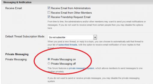

To prevent this forum from all the fake accounts that get created to spam users and the forum we have to restrict PM's from new members until we feel safe knowing that a new member did not create an account here only to spam the forum and its members. I have lifted the restriction on your account.
