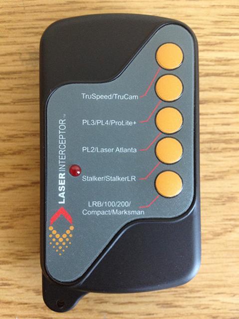

You bet! All it does is is use its IR LED to emit pulse patterns that match those of certain lidar guns, and any jammer which recognizes those patterns will respond accordingly. :)

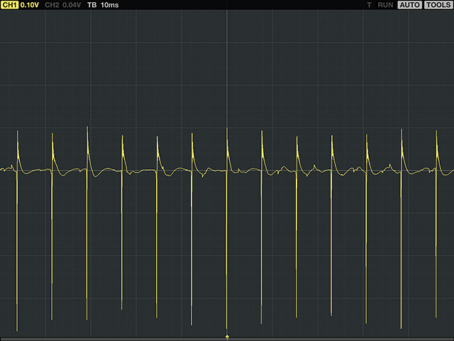

I scope tested mine a little while ago and if you're curious, here's what the patterns look like. :)
First off, the keyfob tester itself.
Attachment 1247
1) TruSpeed/TruCam: 200.3 pps

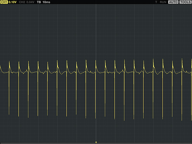

3) PL2/Laser Atlanta: 238 pps

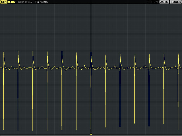

4) Stalker/Stalker LR: 130 pps

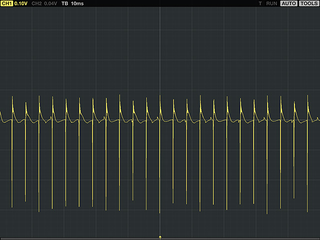

5) LRB/100/200/Compact/Marksman: 125 pps

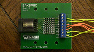

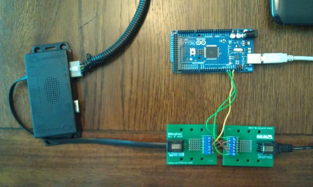

I use two breakout boards and connect a LI head to them. Then use a picoscope to capture the data. Here are some pics:
Attachment 1255
This is an example of my pulse logger.

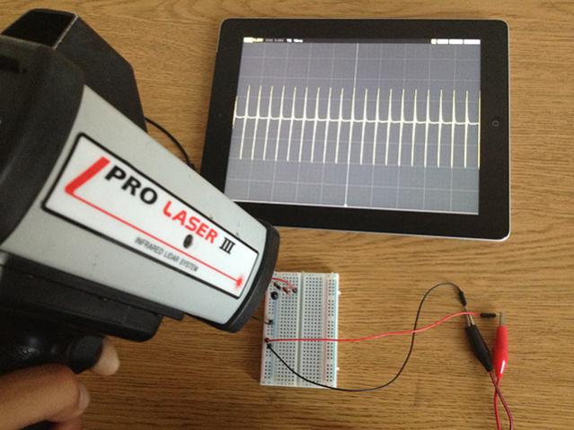

You're spot on. It's done on an iPad, converting an IR photodiode to the 3.5mm audio jack plug and then running an app called "Oscilloscope." Another really good one is "FFT Plot" by the same manufacturer.
Here's the app in action:
Attachment 1272
Here's the components:
Attachment 1273
and here it is put together to measure from a KGE instead of Lidar. (The mess of wires on the protoboard also includes other projects. You don't need nearly that many wires...) :)
