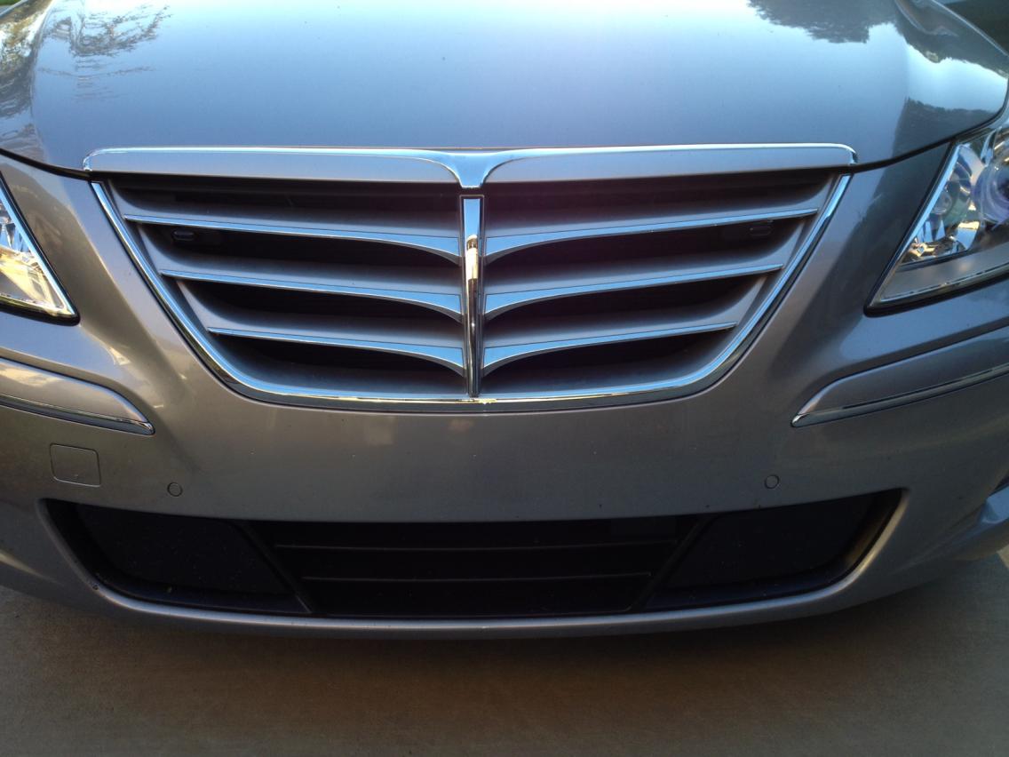

Fronts are installed, Bluetooth and app are up and running. Successfully passed my marksman test tonight with JTG. This weekend's mission is to figure out the rear placement and wire routing.
Great, what kid of car you have? Pict of the front end and your install?
Here is a shot of the front. Hard to see as the lighting was bad. Genesis sedan Attachment 1084
The have a slight cant so they are more or less straight forward, but point taken, I will square and level this weekend
