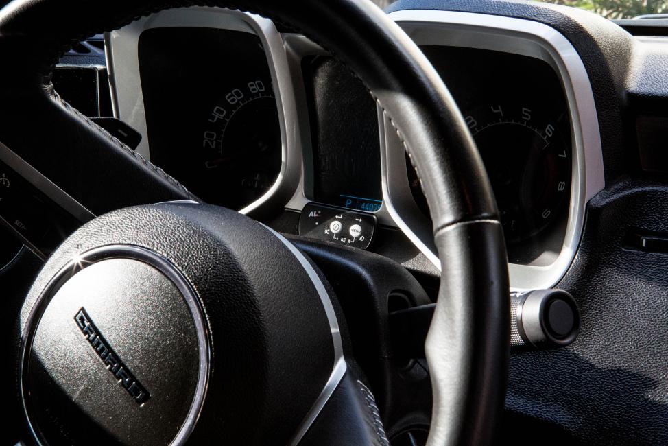

I’ll start by saying the system is extremely small. So small that I thought I had ordered the wrong item when it arrived. The sensor heads are no larger than a key fob and close to a third of the size of the LI head. The only thing I wished this system had was a remote controller instead of the wired controller. I can see that going away when the Bluetooth modules are available since you’ll be able to control everything with your phone, but would be nice to see this in future releases.

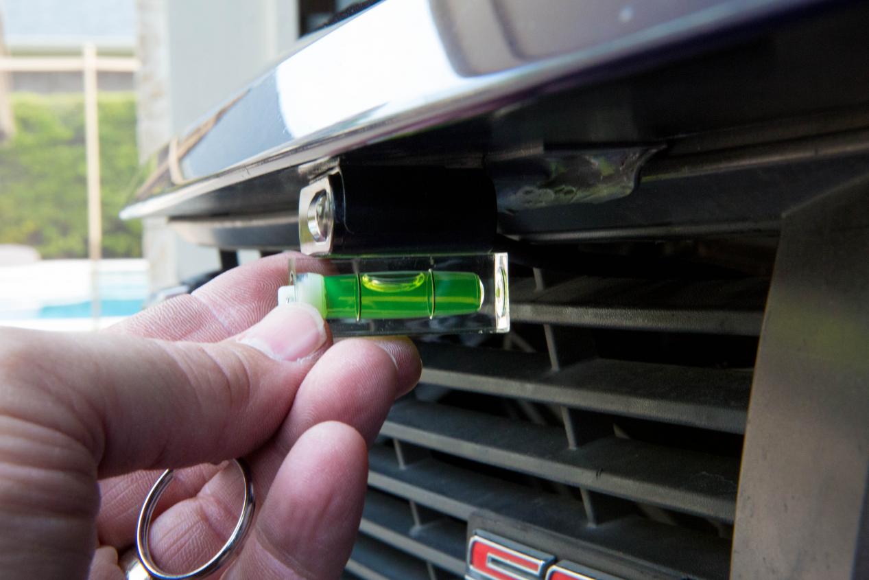

Each part of system is boxed separately making it easy to mix and match to get the system you really want so in the case of an ALP dual you would get 3 boxes. 1 for the CPU, and 2 sensor boxes. Each sensor comes with mounting hardware including a bendable bracket, and RJ style connecting wires. The RJ plugs go into the CPU and the other end is connected via a weather proof din connector to a small 1 foot wire off the sensor head. This makes it easy to remove or exchange heads without having to go back through the firewall. This is very similar to the Laser Interceptor 8.9 heads and connecting cables.
Hooking Everything Up
Connecting the CPU is simple just hook up the red and black power wires and plug into the CPU. You will notice there are two additional wires (blue and green) for connecting to a mute source and a relay respectively. The blue wire can be connected to a stereo that has its own muting capabilities or it can be triggered via a separate switch. The green wire could have many uses, but one that comes to mind is a relay that controls an external brake light kill. Useful for rear laser encounters when you don’t want to apply the brakes.
Attachment 162Attachment 163Attachment 164Attachment 165
