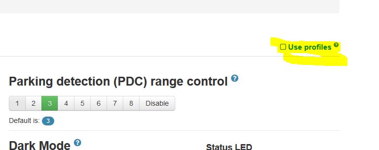

If using the menu buttton on the control pad to switch between parking mode and protection mode. But when i connect to the BT module it locks out the controller but the software doesnt have a option to then switch to parking mode. Without buying a hifi or gps, is there a way software can have a button to swap from parking to protection ?
You can switch Profiles in BT
Sent from my SM-G935T using Tapatalk
Ok great, can you link me to infonthat describes jow to use more than one profile in BT when no hifi is used. Does a usb stick need to be plugged in. Thank you
As Tom says, just check the 'use profiles' on the alpupdate configure page ;
Attachment 5600
Setup your three profiles as you want on the 3 pages (profile A, B & C), download the config.alp file from the website, put on USB stick, plug into the ALP, and you will be able to switch between A,B & C on the ALPConnect app. You can then remove the USB stick
oh you can do that without Hifi ! Awesome.
