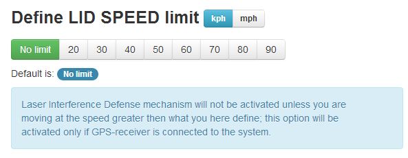

Just received my GPS antenna today and installed it. (Thanks Tom)! I love how I can set my LID Speed limit. I have one question, when testing it out parked in my driveway it displays the yellow car because I am below the speed limit threshold. However when I shoot my PLIII at it it alerts but switches to defense mode until my LID time expires (4 seconds) . I don't have an IR camera so I am just wondering if the heads are firing back. The length of the gps antenna is great for truck owners :D btw.
I configured the "Define PDC SPEED limit" at 20 kph, "Define PDC SPEED limit" at 10 kph but left the radar speed at no limit. Are these settings correct? While driving with these settings my alp connect car stays yellow till I go above 20 kph, but like I said when its yellow and I shoot my system it turns blue.
You need to configure the LID speed limit as well, which is further down the setup page;
Attachment 2209
If you're using the STiR+ as well, you need to set speeds for PDC, Radar, and LID (they default to no limit, unless you change them)
