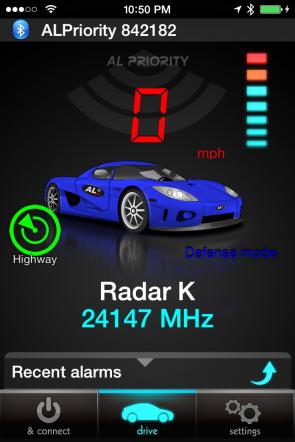

That's weird mine is working fine. Now the only difference is I have the latest ALP Connect which might be the issue.

Disconnected Bluetooth and plugged in Control Module and Radar is working on the Control Module as well.
