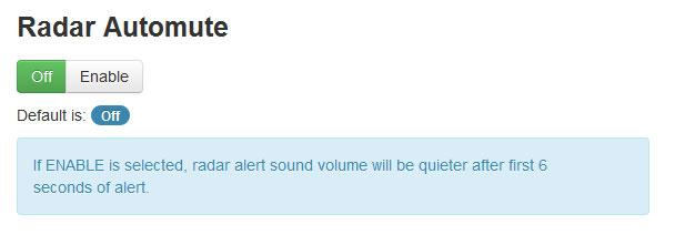

Auto Mute on the Radar Alerts is set through the setup file. It is a feature and the settings are listed under Auto Mute in the Sti-R settings.
Attachment 2131
Yeah I am used to it going quiet but not going fully quiet ;) .

Just tested 1.5 and auto mute worked perfectly.... 6 Seconds Full Alert and then reduced volume for the balance of the alert.
