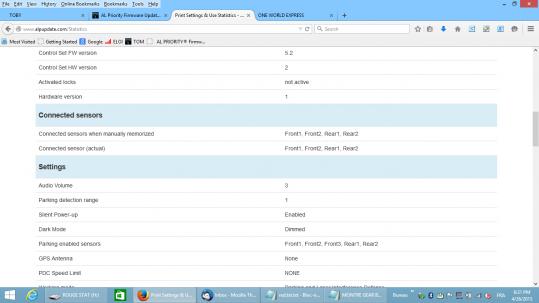

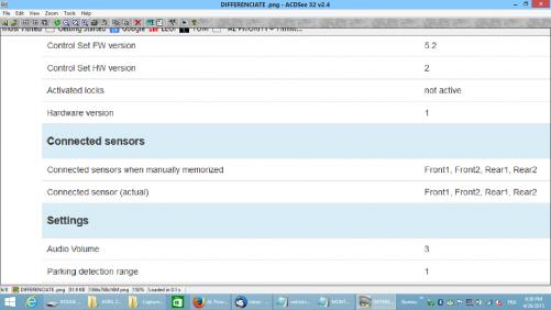

I just notice that my system does not differenciate Front\Rear shots .
When i shoot at the rear it says Front . I did a restore and memorize sensors but no change .
What should i do\check ?
I physically disconnected\re-connected the sensors , re-did a restore , and definitively there is something wrong with my 5.1.1 ,
shooting front = front alert
shooting rear = front alert
And before the update , all was normal .
Attachment 3955
Attachment 3954
It's a bug in the new firmware alerts. It does not effect performance.
