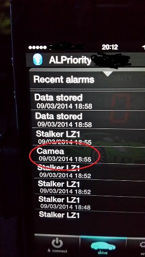

Never Heard of that one before, happened when I was doing some testing with my Stalker
Attachment 970
Czech automatic section speed camera. ALP can detect IR reflector of that system even during the day.
http://www.camea.cz/en/traffic-appli...eed-control-2/
Where did you buy your unit? I think that there is no CAMEA systems in Australia.
It's possible that ALP caught few pulses of your Stalker while you didn't aim the car and that caused CAMEA alarm. After that it switched to Stalker.
It's weird only because CAMEA should be disabled in that region (that's the reason why I asked you where did you buy your unit.

I still sent AL a recording as the Camea thing has me wondering?
Attachment 971
ST - Isn't yours an Aussie version, which is actually the EU version in km/h if that makes any difference ?
Camea falses - I had two in my logs on retail release firmware, but I also got two a couple of weeks ago on 4.3.4 firmware just after dark, but put that down to a motorbike headlight that was behind me. As KrpA says, they shouldn't really be enabled on Aussie regional firmware.
