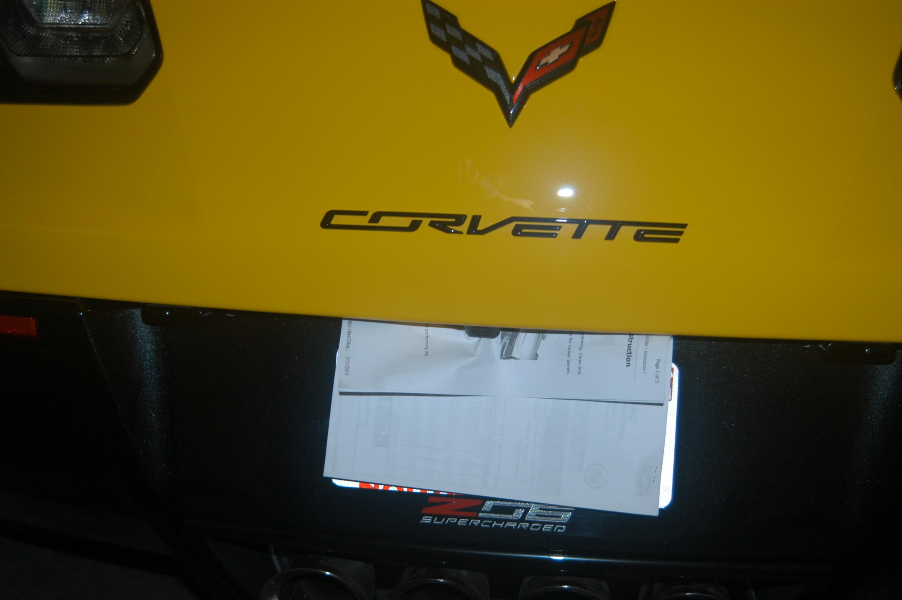

I just pulled a tape along the contour of the front and it was 25 1/2" between the sensor. It looked like 24 3/4" actually between the inside edges of both sensors. If you think that's the problem I can move them closer together or if it would be better buy another sensor. The rear sensors are only 20" apart and I had the same results with pt's.Attachment 4715
