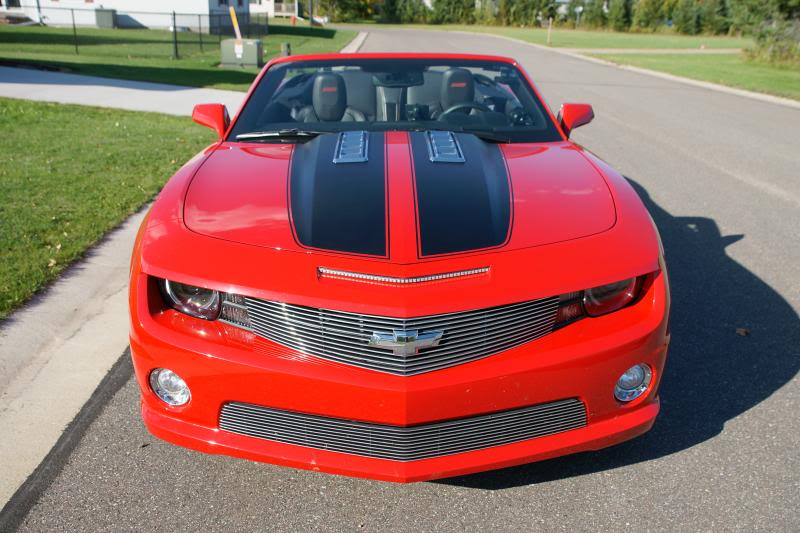

Attachment 3252
And here is the front of the car for sensor placement. Thanks All

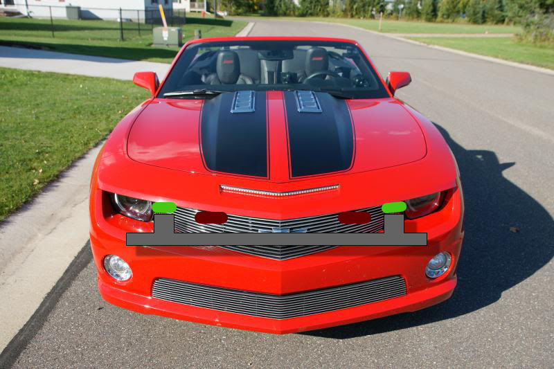

Attachment 3253
The green locations are the most stealth because they blend in with the turn signals, but both options are solid. The trick is making sure that the heads are pointed straight forward and are level to the ground. The Camaro SS has a curved front facia which protrudes forward at the Chevrolet symbol. You will need to build a jig to ensure your heads are both pointed straight out. The gray bar represents what I'm talking about. Just make sure the angles are perfectly 90 degrees and the measurement of the arms are exact.

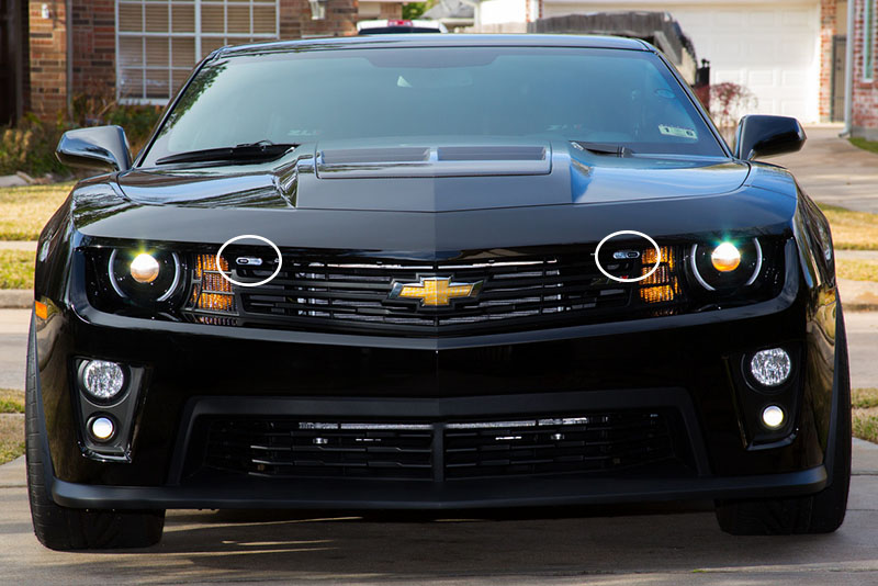

Attachment 3254
Here was the original placement on my vehicle. I've since moved them to the green locations on your car for a more stealth look and I have a 3rd head mounted above the Chevrolet symbol. Nothing gets through this setup
