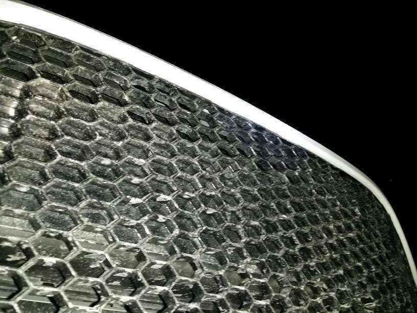

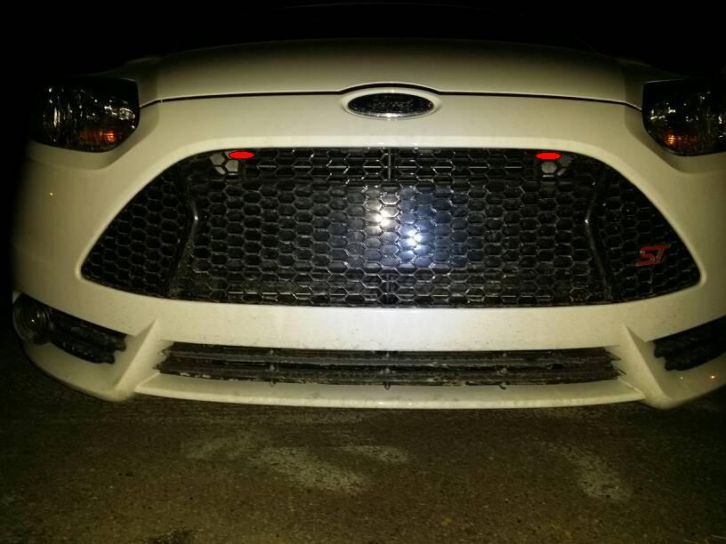

If its that snug you might be able to just mount the head without the bracket.
Attachment 720Attachment 721Attachment 722
Sent from my SM-N900V using Tapatalk
If the head will fit in the grill at the widest point use some silicone that will hold them in my fronts are held in with silicone
For any laser jammer installation you will need the cut the grill. If you want to get fancy, you can build a scaffold out of aluminum between the grill and radiator to attach the jammer head brackets to. If I remember correctly, there was a member on the other forum EX35 that did that for a installation on a BMW x5.
Had to cut my ST grill to fit in the LI but it is the 2010 model
This would be my choice location.
I would remove the grill , grind from behind to make a nest for the baby , then install
it flush leaving a 1\8 '' to sit an Irt plexi ....stealth\secure.

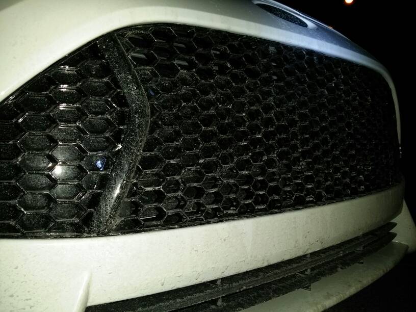

Attachment 723
This doesn't look that hard at all to solve & have an idea for you.There's a Ford dealership the next town over from me,I will stop by later today to see if they have one in the lot so I can take some measurements.
The hardest part is knowing where to get thru the firewall...have you figured that out ?
