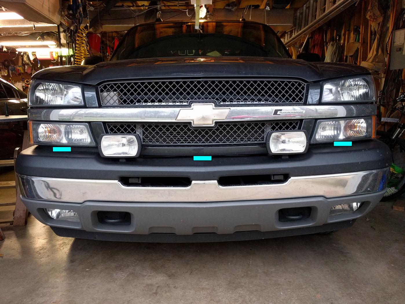

Please give me your position opinions on a triple sensor setup.
You can see my Lidatek LE30 Dual in the bumper air slots. The easiest installation wise would be my blue box marks.
Thanks
Attachment 5629

Your spacing distance looks to w-i-d-e by placing the outer ones under the HLs. You want to shoot for spacing distance (between any 2 adjacent Transponders) to never exceed 24", ideal spacing is between 20-22".

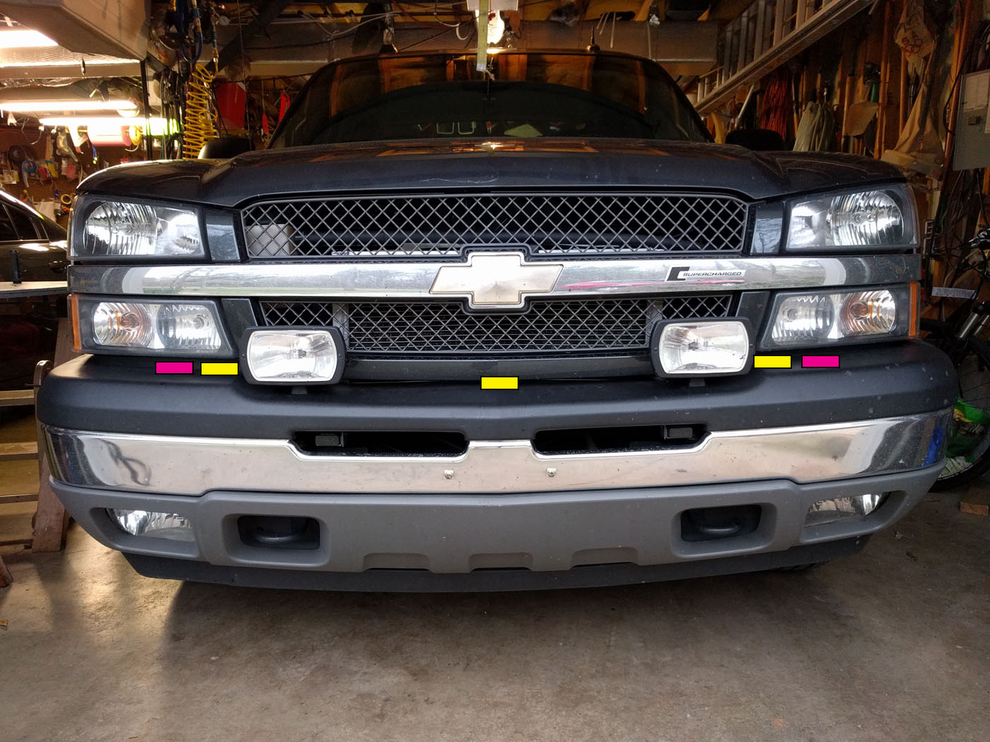

Good eyes. The violet hashes are 22" and the yellow are 20" on the centers. 20 kind of puts their faces too close to the auxiliary lights perhaps causing an off axis blockage. If I have them protruding 3/8" from under the DRL lights the sensor faces would be 3-1/4" behind the aux light lens.
Thanks
Attachment 5630
