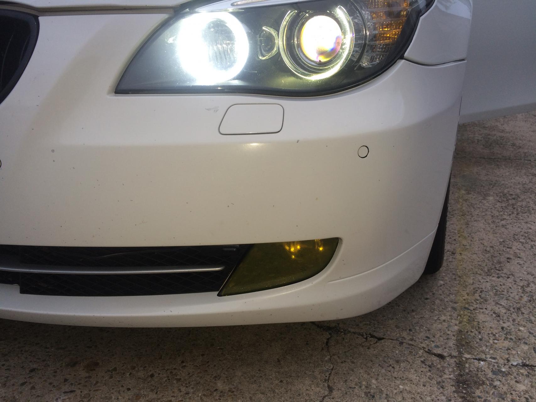

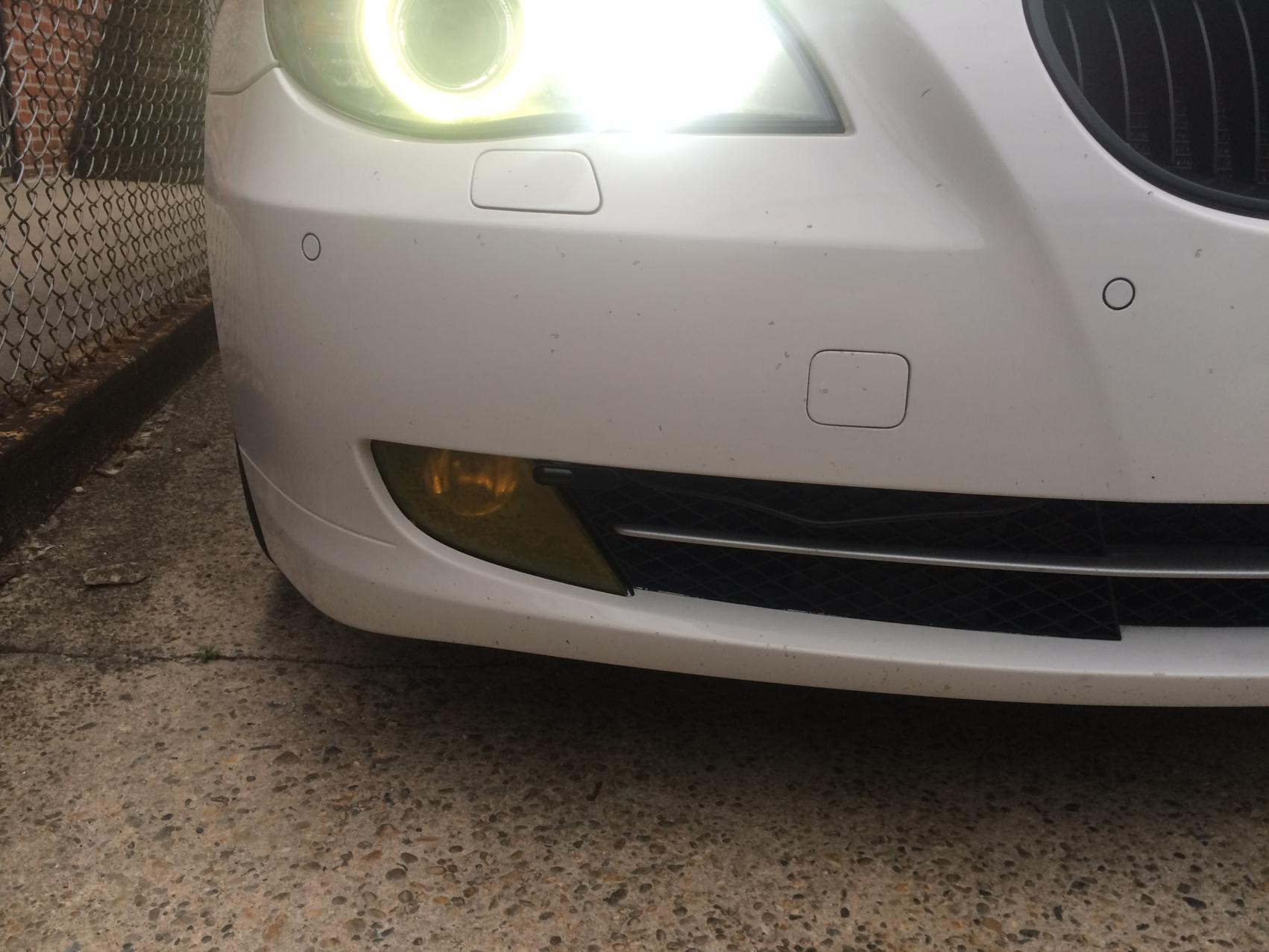

Hi, I installed my dual alp recently and I am having trouble with them. :frusty: . I tried factory resetting the alp couple of times, no use at all.
First, the alp stays in parking mode only until i walk past both sensors. I must walk past both sensors in order for it to go into defense mode(blue led). When the alp is in parking mode, I cannot enter menu mode or anything besides turning off/on the device.
The second issue i am having is my alp will spazz out non stop when it detects a laser. I went ahead and used my bushnell tour v4 to shoot the head and the alp does "somewhat" jams but i would still get some punch-through(directly shooting maybe 2 inch above the heads and i'm about 15-20yd away). After i stop shooting, my alp control box is still stuck on alert mode and won't stop. :confused:
I pulled the stats for the alp: (the connection is 1 and 3 because i pulled my center head out for warranty. I tried connecting the connection into slot 1 and 2 but did not fix any of my errors).
