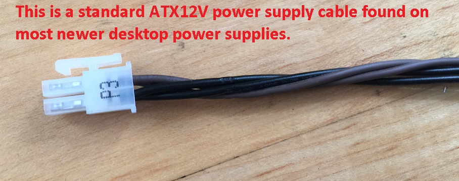

1. Obtain a newer desktop power supply unit from a computer being tossed into the garbage, or one just lying around. Cut off the 4-pin ATX 12V cable and connector coming out of the power supply unit. The color of the wires will be different from the original ALP cable, but that doesn't matter.

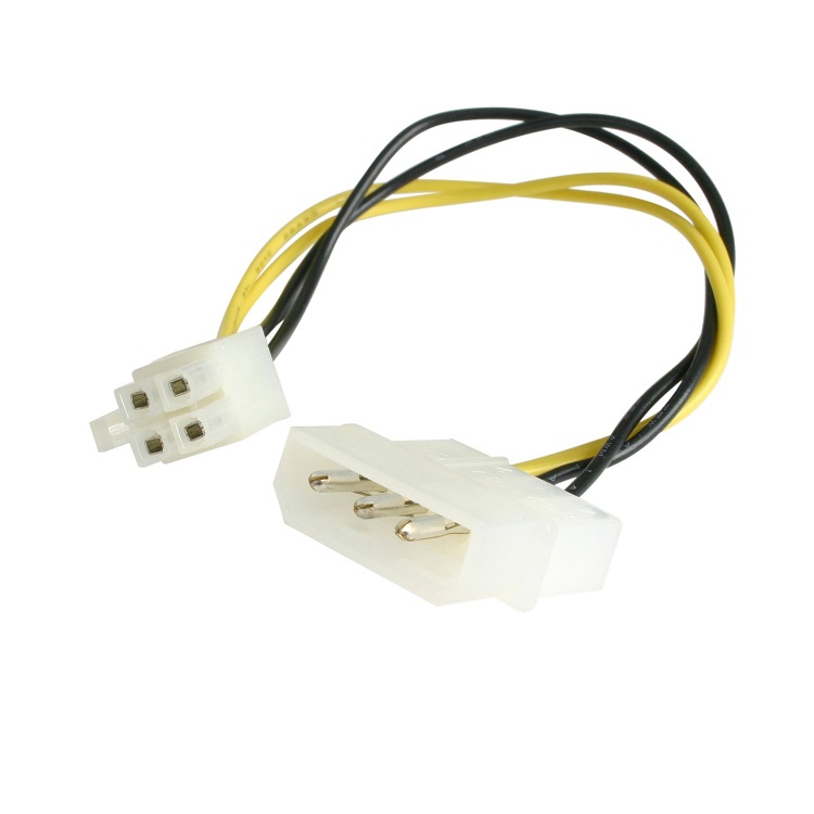

2. Go to eBay or Amazon, and search for a "4-Pin ATX12V to 4-Pin Molex Adapter". See picture below, then cut off the Molex connector. I've seen these go for as cheap as $2.65.

I didn't have any issues myself, and as you can see in the pictures, the ALP works just fine with the 4-Pin ATX 12V Cable I pulled for free from a computer destined for the trash.

My discarded/used 4-Pin ATX 12V Cable
Attachment 4803
A picture of a 4-Pin ATX 12V to Molex Adapter
Attachment 4802
Tested my 4-Pin ATX 12V Cable on my ALP. Everything works!
Attachment 4804
