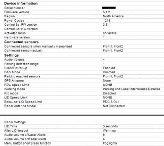

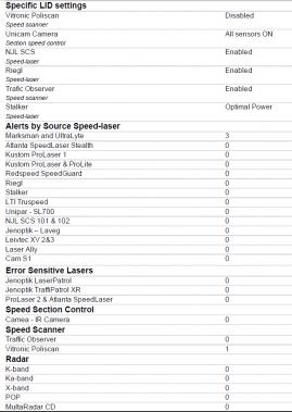

When I am watching video from this case in another forum and the time on the original movie I see:
The alarm started when the time is 13th s but he started slowing down in 16th s and when the time is in 17th s he really drove slowly. This is what I see.
So let's get this clear. The gun could not clocked from 13,25 s to 16,25 s and probably clocked him in somewhere between 16,25 - 16,5 s, because the heads were off from 16,25 s. They worked only between 13,25 to 16,25. He started slowing down from 16,5 and it was definitely to late.
And what I see he drove clearly slowly in 17th s, but it doesn't matter.
Conclusion: Only the driver failed, the device was good.
Either the reaction time should be better or the time which is set in software should be at least 5s.
PS. Of course it could be installed a little better, but in this case it doesn't matter.
