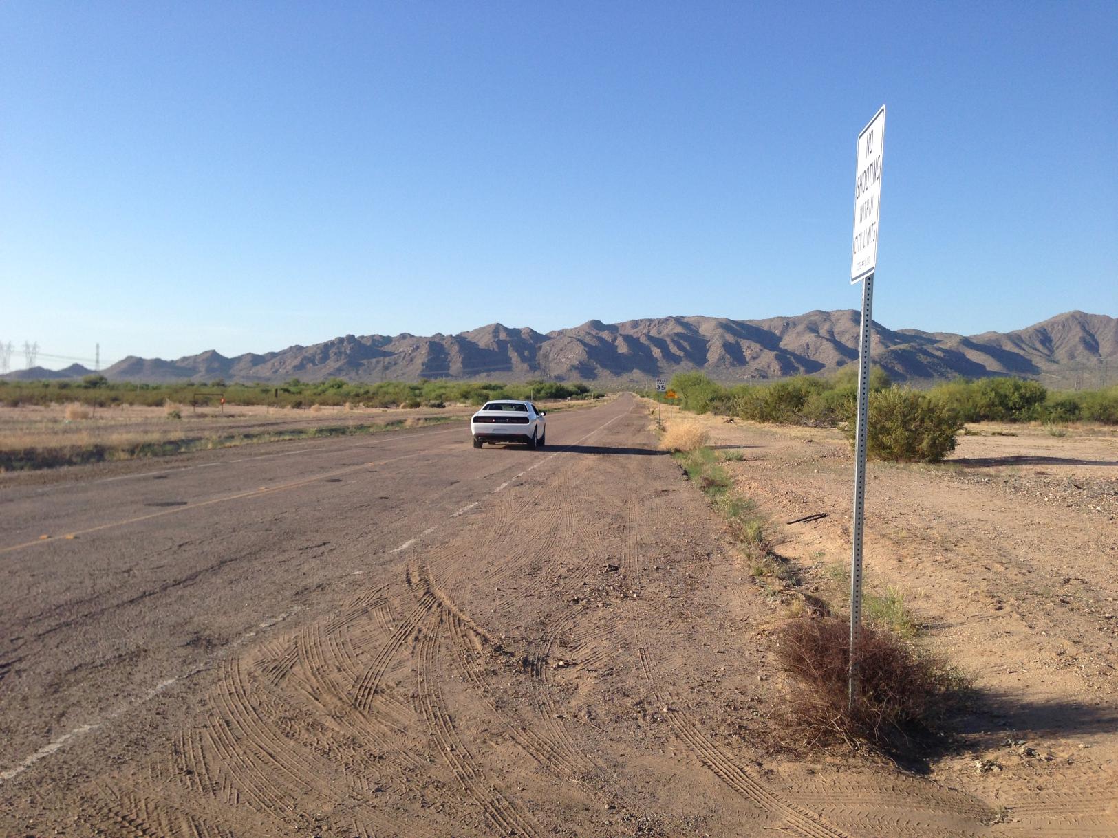

The Test Course:
A relatively straight 2000 feet 2-Lane road. The shooter was positioned on the shoulder of opposite side of the road than the test vehicle was traveling. The shooter was approximately 12 feet from the testing lane. There were no line-of-sight obstructions between the Shooter and the vehicle. Any punch through from a distance under 100 feet was considered a Jam-To-Gun and recorded as such. If you get a speeding ticket by a handheld LIDAR and were shot less than 100 feet from the LEO, you deserve the ticket!!!

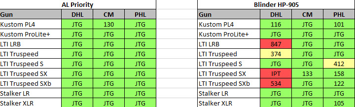

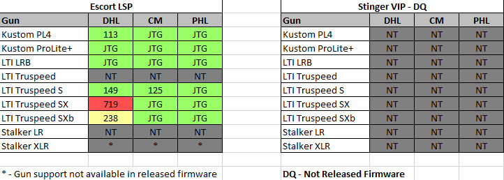

The car used for the testing of all the publicly available firmwares for the Escort Radar Laser Shifter Pro, AntiLaser Priority and Blinder HP-905 was the Nissan Altima. Each laser jammer utilized two sensor heads and they were mounted in the same exact position on the Altima. Each were aligned for "true-zero" azimuth (Horiz.) plane and also "bubble leveled" for vertical plane. They were checked for trueness and where leveled. We are not including the data or discussion for the Stinger VIP here as the tested firmwares were not publicly available at the time of testing.
Results:
Attachment 3970
Attachment 3971
Discussion:
As has become the norm and expected since the release of AL Priority, it performed flawlessly in this test.
The Escort Laser Shifter Pro tested very well. I am not too concerned about the punch throughs by the LTI TSSx and TSSxB. We are looking into what contributed to those issues and will report back on the Forum about them when we have more information.
In regards to the Blinder HP-905, we are a little concerned about the punch throughs achieved by the LTI LIDARs on the Driver's side headlight. I believe this issue is being addressed by Blinder, and will see correction of this in the future.
Overall we saw good performance with very few punch throughs on all three of the laser jammers tested. In real world situations, I would expect all of the jammers to provide Jam-To-Kill performance.

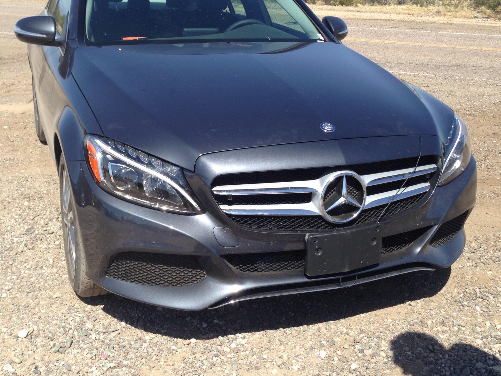

Here is the front of the car Stinger mounted their laser jammers to. Please pick out the jammer heads.
Attachment 3928
Attachment 3975

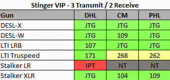

Against the guns tested the Stinger VIP tested extremely well especially considering that the Stinger came to the test without being programed to jam most of the guns we tested it against. We were told with the exception of the Stalker XLR and the DragonEye Technology LIDARs, the Stinger VIP used its generic jamming algorithm. We didn't have the opportunity to test the Stinger VIP against our entire inventory of LIDARs because the engineer and representatives of Stinger also needed the car for radar testing as well, and used this event to further tweak the Stinger VIP firmware to improve its coverage of LIDAR threats as well as to improve its overall performance.

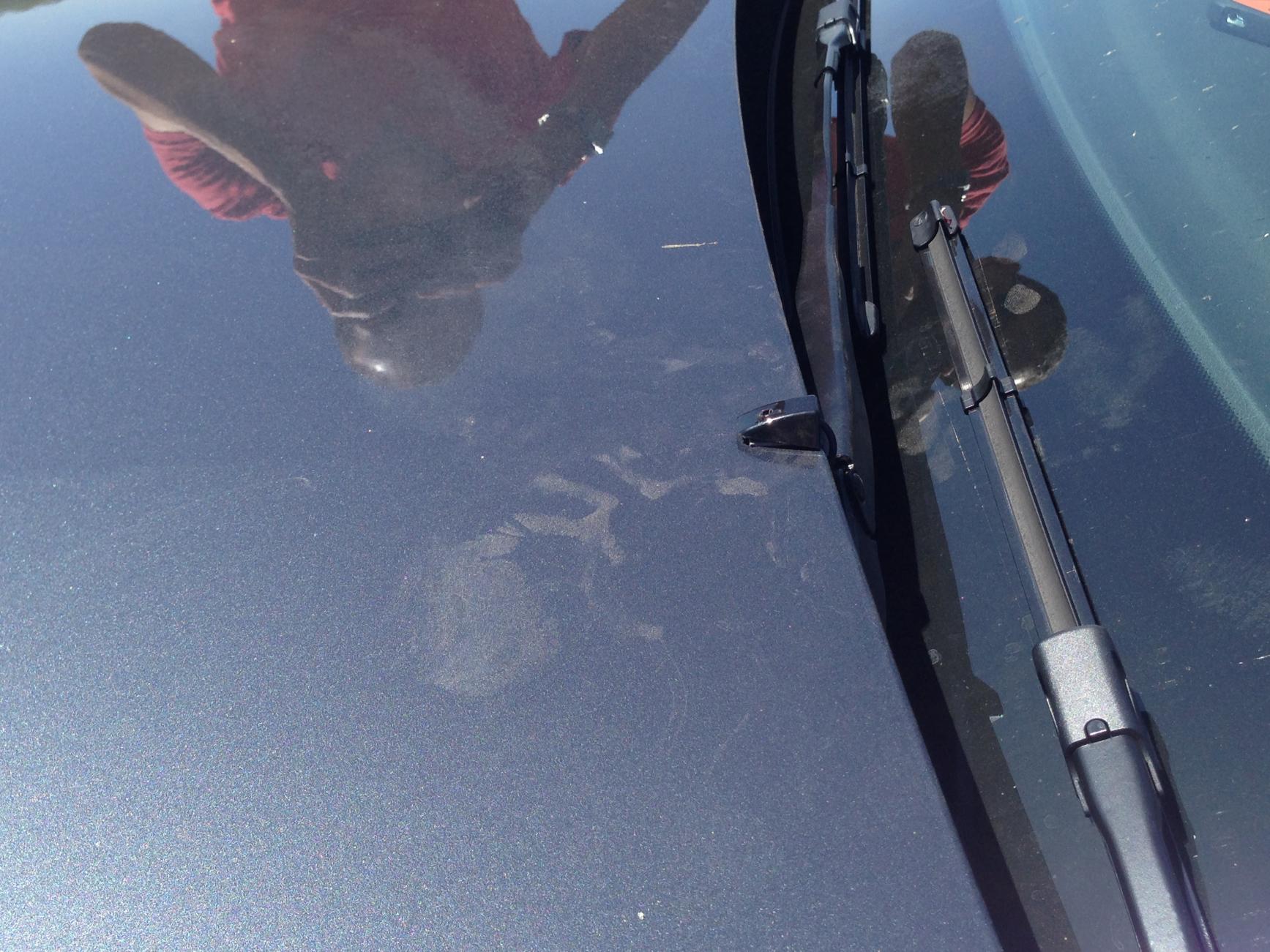

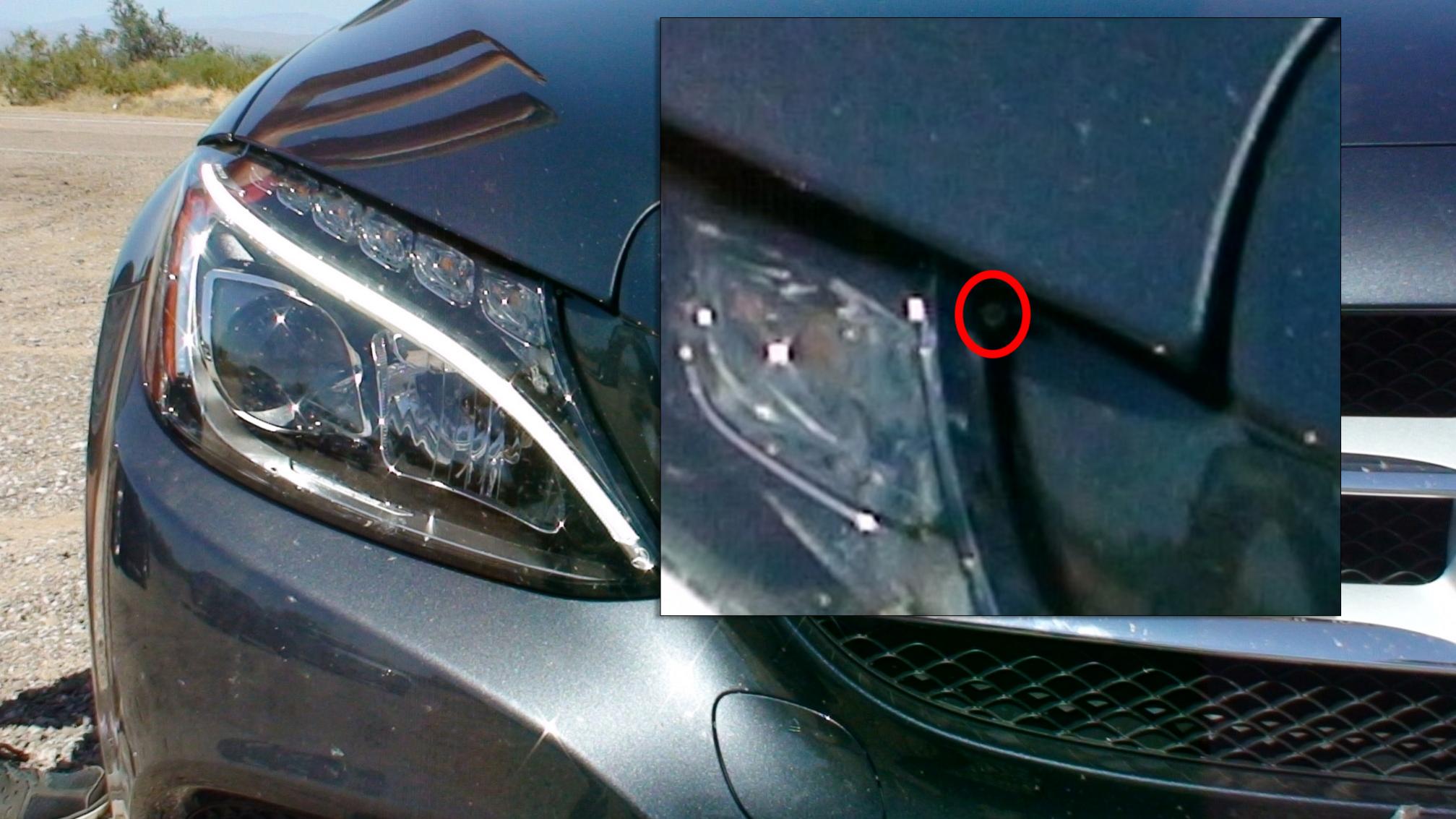

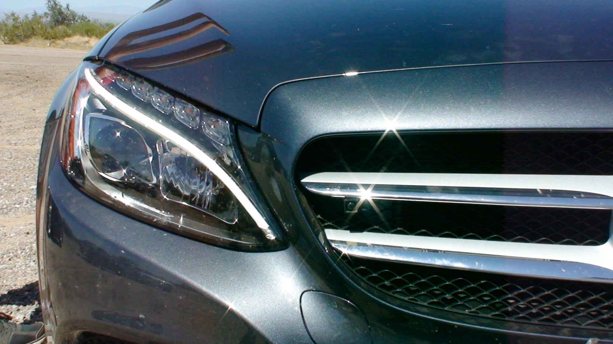

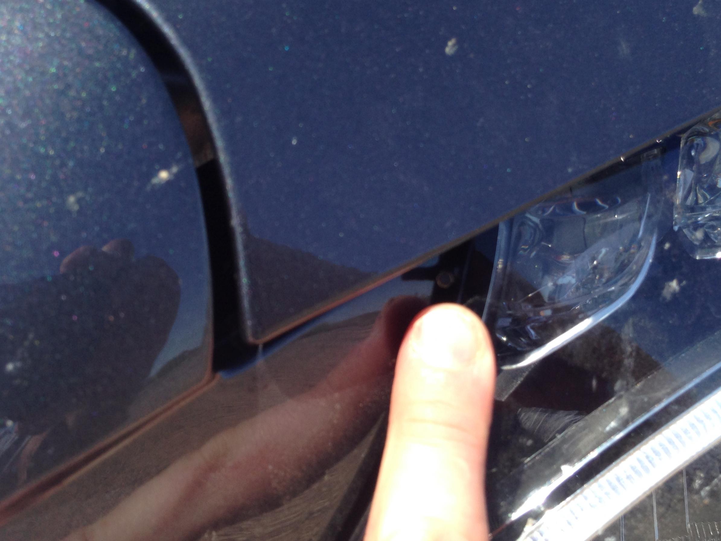

Did you find the jammer heads? Are you sure? How many did you find? We will help you out, there are five (5), yes 5 components on the outside of the car. You can ignore that wire that goes behind the license plate holder. That is the radar antenna head wire and the radar antenna is mounted behind the license plate holder. Give up yet? Not yet? Still looking? Let us help you out. Here is a closeup of the passenger's side. There are two components in this picture
Attachment 3972

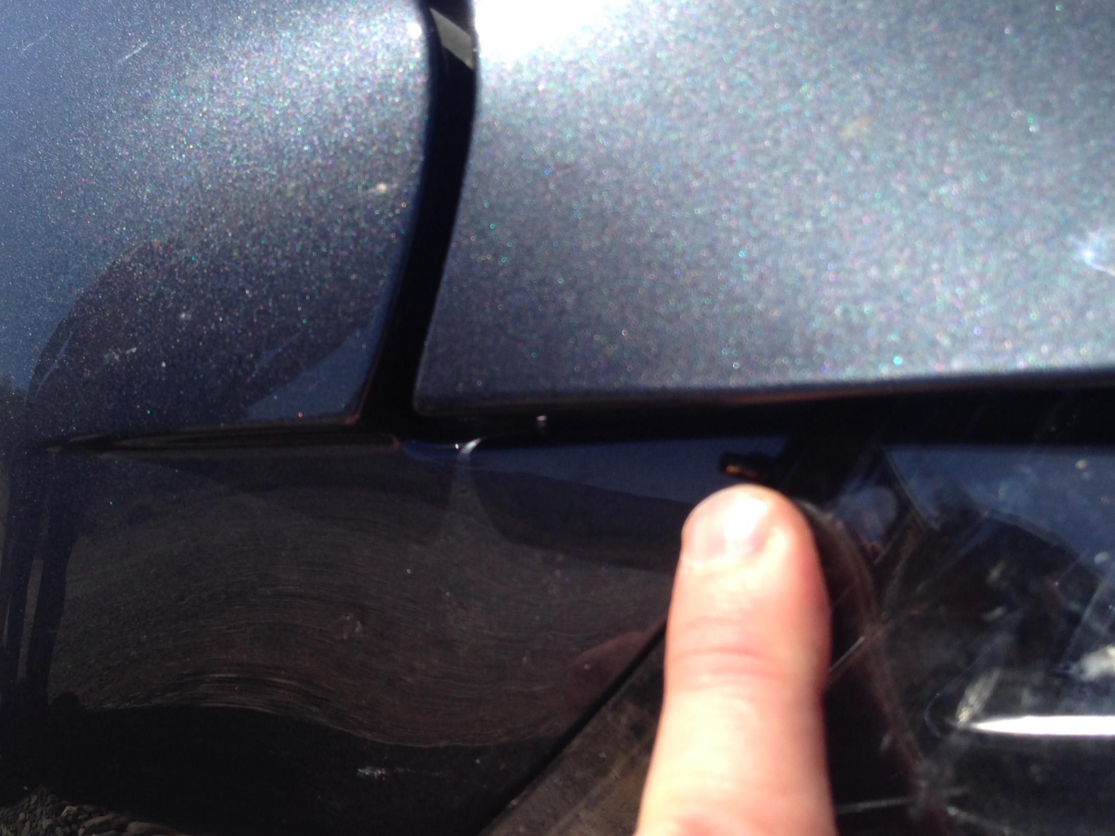

I know you see one of them, but do you see the second component?
Attachment 3973
Attachment 3931
Attachment 3930

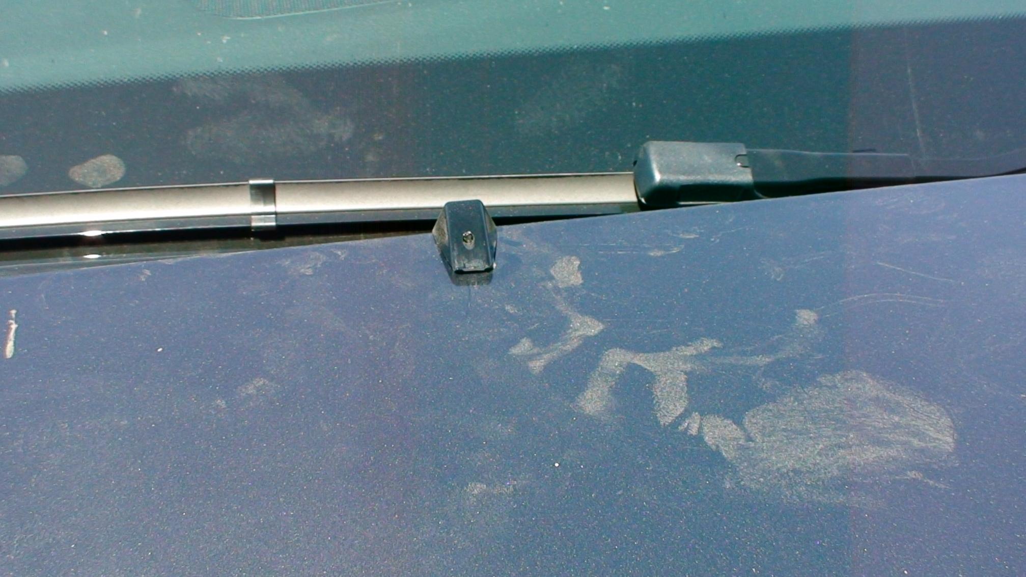

Did you miss this one from the first picture?
Attachment 3974
Attachment 3932
We couldn't believe it ourselves! There are two receive heads circled in red and three transmit Fibers circled in green. WOW! They are so small, just 3MM in diameter, that they put one in a windshield washer mount. Talk about stealth install!
So do you need three transmit fibers? Probably not, in most applications two will probably do. So why are there three? One reason was because of the course that Stinger had tested on prior to the meet. Did the third head contribute to better performance in our test? Possibly. We will test the the Stinger VIP laser jammer comparing three fibers to just two fibers. Prior and during the testing we didn't look that closely at the car and had initially thought that the receive heads were both receive and transmit with a transmit fiber inside of it. It wasn't until we had finished testing and we're leaving the course, they asked to meet elsewhere to show us their "little" secret.
Is the Stinger VIP laser jammer ready for market? No, not quite yet as they need to program the jammer to counter more LIDARs. But based on the performance we saw, and the ability of the Stinger engineer Patrick to address neutralizing guns it wasn't previously tested against or programmed to defend against gives us great confidence in their ability to develop firmware on top of having confidence in their hardware.
