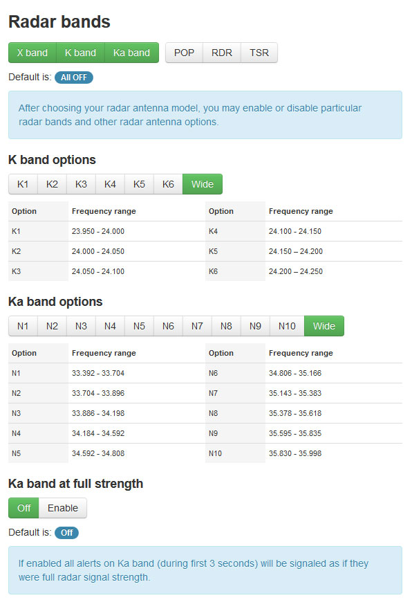

Just wondering if you can do KA band segmentation if you use the R/G module with an STI-R receiver? I assumed the answer was no but figured I'd ask just in case

You are incorrect. You can not only do band segmentation but you have RDR, TSR, POP toggles as well. View the ALP Update site and choose the Sti-R Plus as a connected antenna and you will see all the options available:
Attachment 2887
If you click on the Bands you will see the Segmentation Options:
Attachment 2888
Oh snap! I have never selected it so I didn't know that. Looks like I'll be picking on of those up in the future.
