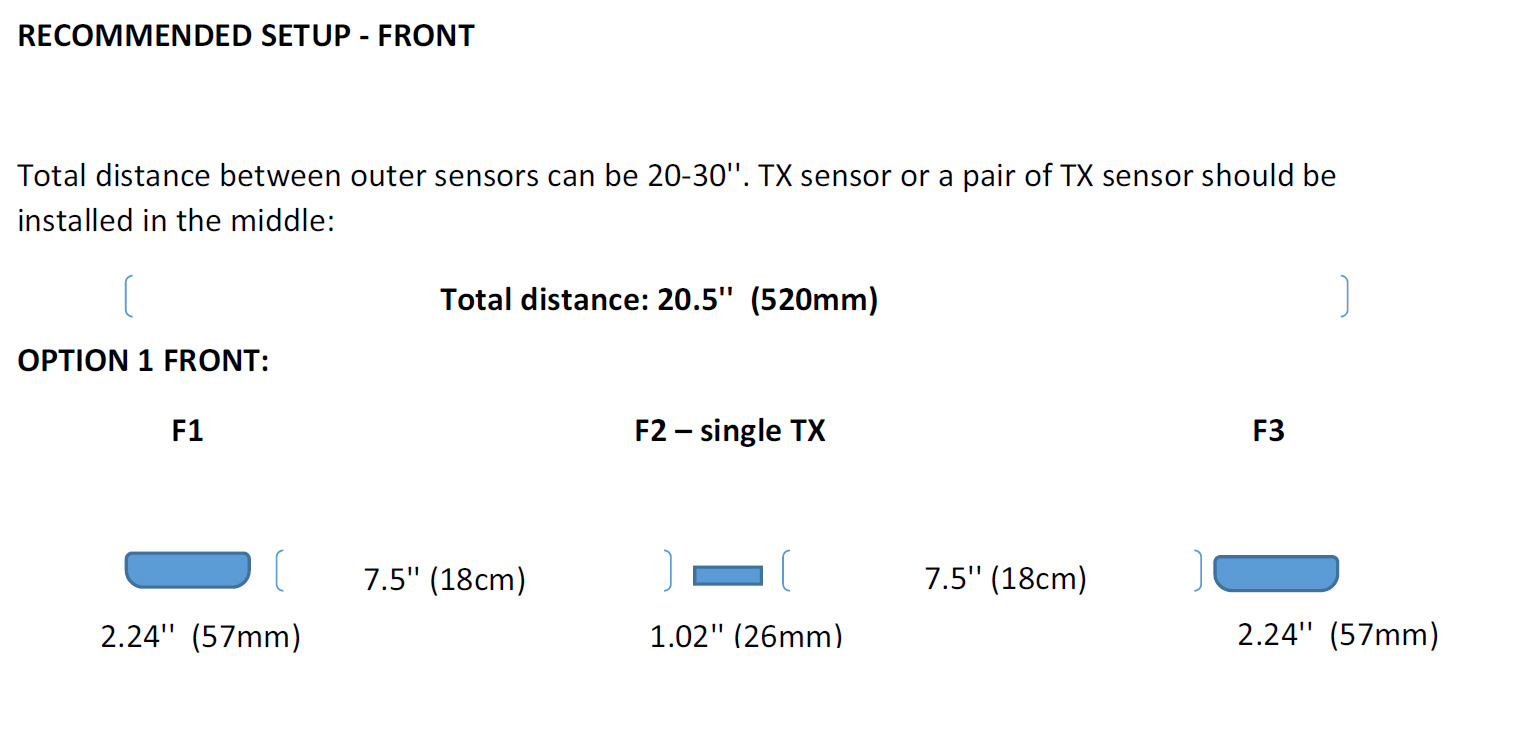

Ok, so time to add my data point.
Yes, I ran into issues with my setup (will decline to say further).
In my case, the distance between F1 & F2 is 10", and the same for F2 and F3.
The total width of the entire install from outer to outer is only 26" though.
Here's my question Prior to me ripping everything out and starting again (which I'm prepared to although I'll need to buy a new grill then (sigh), is, is there any harm in trying to flip the orientation of the heads? That means, receiver (bubble) will be towards the center of the grill. This buys me 1" one either side.
I can't imagine anything wrong with that as long as the 7.5" minimum is still there.
Thoughts?
