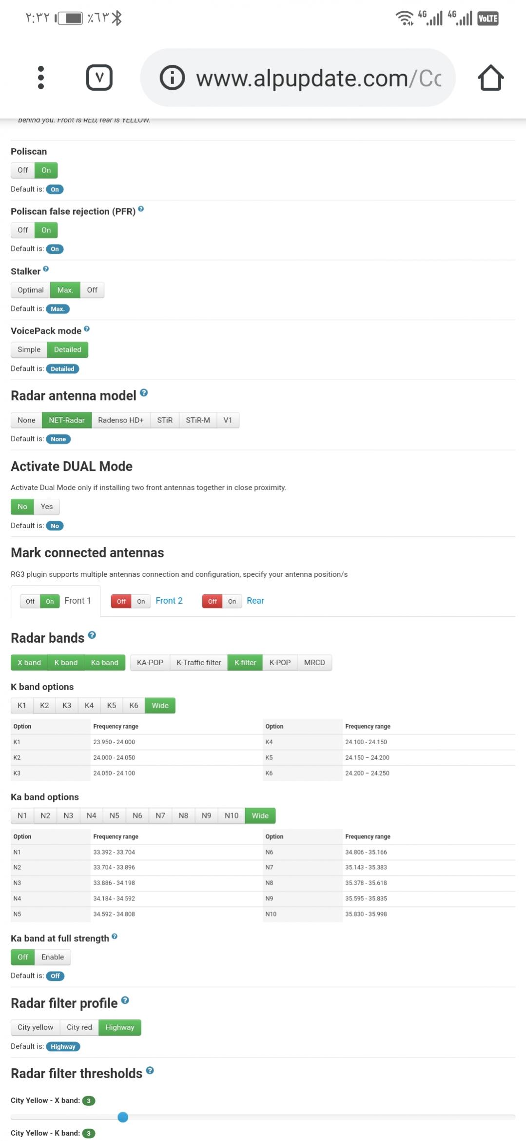

    But according to the settings of the net radar it monitors this frequency but I think here is wrong in the update or just needs to adjust according to the settings shown in the options of the frequency

    Yes, I've seen the settings before.
    The FCC test report says 24.050 - 24.250 GHz on K band;
    https://fccid.io/2AHMC-NR-DSP/Test-R...Report-3483363
    As far as I'm aware, there were never any 'international' models developed for the overseas market, with different frequency ranges

    NR does not scan lower that 24.050. The K Band ALP muting segment's were when we used old Sti-R M international antennas.
