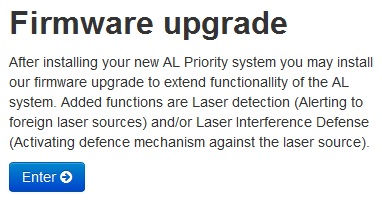

Update the firmware of your AL Priority - Go to http://www.alpupdate.com Under Firmware Upgrade hit the enter button:

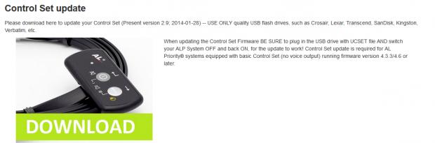

Usually with Firmware updates there is a matching Control Set Firmware that will also need to be downloaded: The Control set (Either the Standard or HiFi) firmware is listed on the same page as the CPU Firmware and will look like the following:
Standard Controller: (Non HiFi) - you will need to download the current UCSET.bin file: (Green Download Button)
Attachment 1404

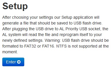

Go back to the ALP update site (The main home page) and this time under SETUP hit the enter button:

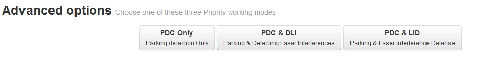

Scroll to the bottom and look for Advanced Options:
Attachment 70
If you want laser defense you will need to select: PDC & LID and once you click that option a new menu will appear with all the advanced options.
Laser Defense it set at 4 Seconds by default. Please do not choose Unlimited unless you are testing your system. You can scroll up and down and check all the options available to you and when you are done just click the Save & Download button at the bottom and save setup file to your USB Memory Stick
