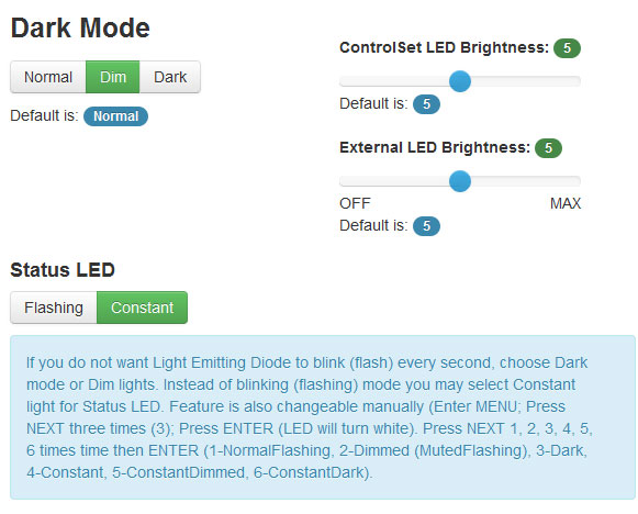

Details of the 3.5 Control Set update (12/22/14)
New update released for standard control set: Control Set Firmware updated to 3.5 (Required 4.5.2 CPU Firmware)
Brightness of the LED in Dimmed mode is now user adjustable in 10 levels.
See new settings for the LED in the Setup Tool Application on the ALP Update Site: http://www.alpriorityupdate.com/Setup
Attachment 3211
Please Note: The Control Set LED is adjustable for ALL users but the External LED's are only adjustable for users with V2.0 CPU's which we switched over to sometime in early October.
